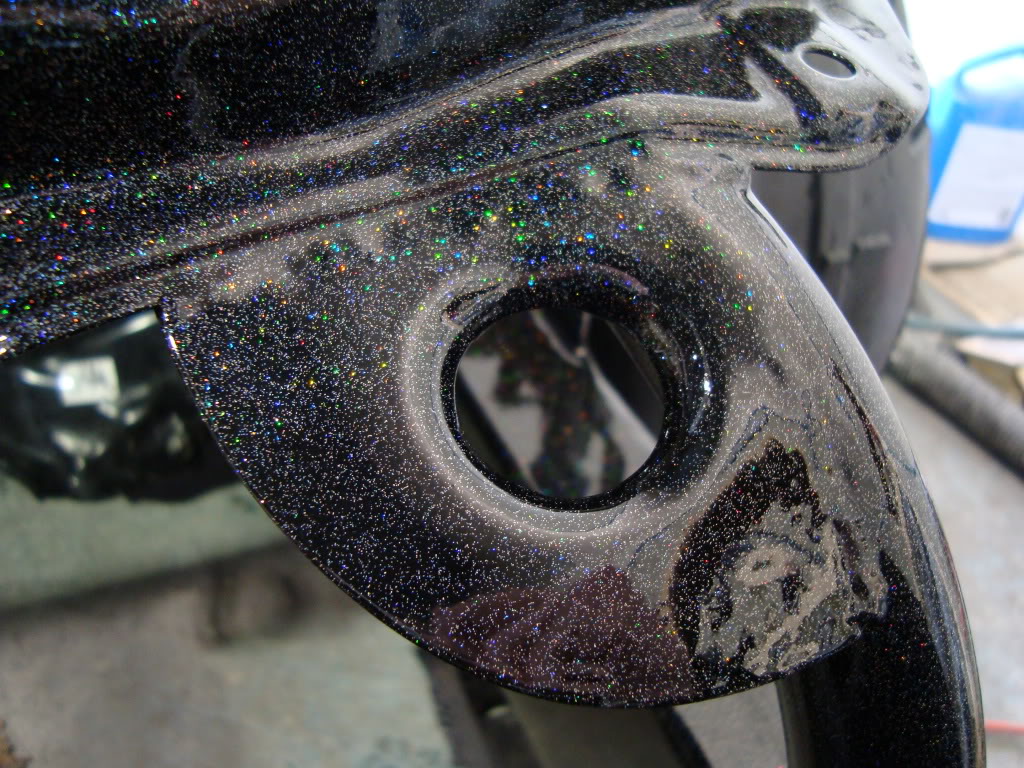

update !! maRCH 28 2011
engine in....some parts in...some wires done....
distance between the rad and the intake manifold
intercooler and rad
tranny from a tank
the under side
SPECIAL THX TO
intercooler and rad
tranny from a tank
the under side
SPECIAL THX TO
