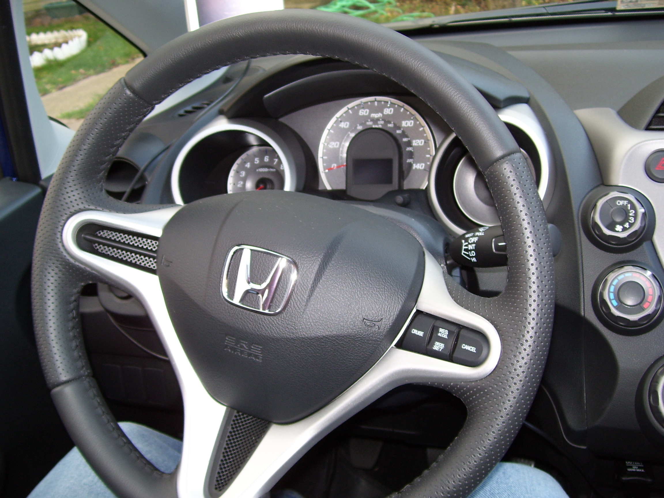

Right now my steering wheel looks like this (sorry about the large image but I can't resize it):
But I would like it to look like this:
Looks like you would need the new OEM Nav radio to do Bluetooth. I would save your cash and buy a radio where all that stuff is integrated for much less money than the $1000+ USD that they want for the Nav system.
