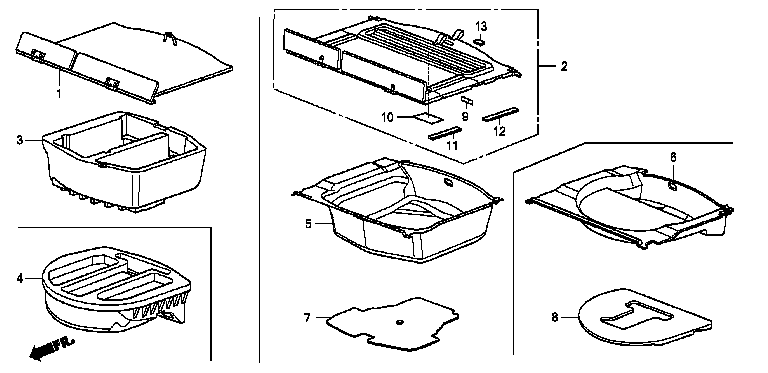

JDM_DOHC_SiR, are the differences between the two markets just on the exterior of the car? I'd like to know if there is a reasonable way to add Refresh mode back in. I find it silly that the USDM brochure calls "People mode" a feature.
I also believe the Fit features a "ULTR" luggage floor in the back. Probably won't work with the spare tire in the USDM model, but from the looks of it on the Japanese website, I think the only product truly missing is that middle shelf accessory.
Great job on that parts list so far!

As far as the Refersh mode I belive that you would have to use the JDM front seats..... since it looks like the USDM seats have been made larger for us ( BIG PEOPLE ).. .... Anyways..
Now for the Rear ULTR floor in the back... there is actually 3 different versions the middle shelf is actualy the floor it self that folds up to produce it and to allow storage in the area that the spare tire would sit on the USDM fit.. Have a look at the following diagram #2 is what would be needed to have the mid shelf option.
Thanks for the props`
