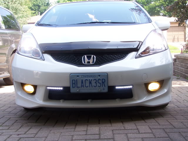

Very similar if not the same
I got them here
http://www.ebay.ca/itm/150828721923?...84.m1497.l2648

Sorry no night shots.
No switch they are connected to the ACC circuit so on all the time. I just used an add-a-fuse and fished the wire through/around door pillar into engine bay.
They are mounted with two self-tapping screws. Just drill small holes in bumper.

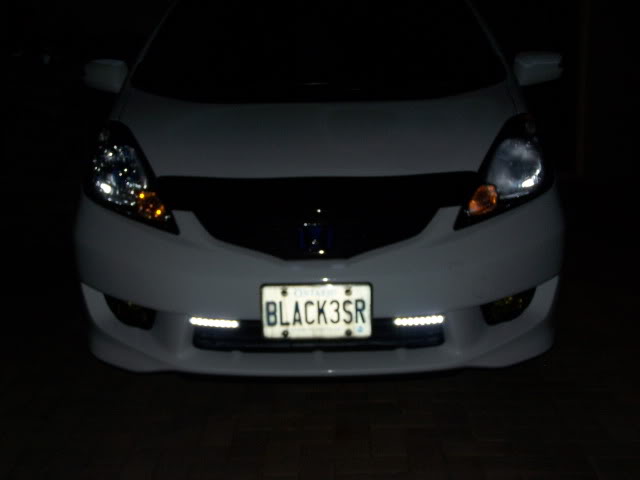

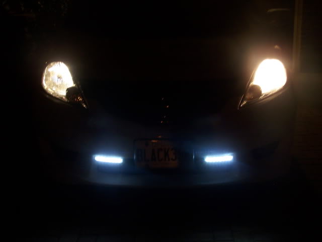

New night pics. My lens fogged up taking it from cool AC to humid outside air. They are rather bright. Not bad for around $12.

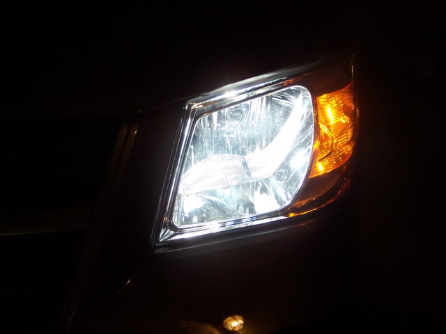

While I was out there. A pic of my new white bulbs for the Caravan. Only $15 from E-Bay. We will see how long they last.
